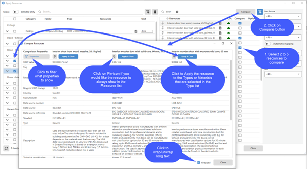

Compare Resources
Select 2 to 5 resources to view their details and compare them to use the best suited one.
All resources selected for Compare and their properties are shown in the Compare dialog box. The resources are ordered by GWP Value with the lowest value first. GWP Value is displayed for the most common unit supported by the selected resources. If N/A is displayed instead of GWP value, the resource does not support that specific unit, but it can be used with other units.
You can filter out what properties you want to see in by clicking on the Properties button. You can choose to Apply one of the resources to the Types or Materials you have selected in the Type list before starting the compare. You can also choose to “Pin” the resources for later use; it will show up on top in the Resource list after you close compare dialog box.

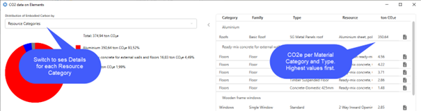

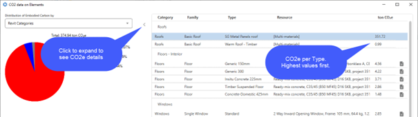

Detailed Results
See calculation results for each Type.
Click the arrow in the CO2e Calculation tool to extend the dialog box to see detailed calculation results for each Type.
Change to see detailed result based on Resource Categories.

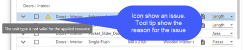

2. Better information of issues with selected Resource
We have added a status icon that shows if there are any issues with the resource applied to a Type or Material.

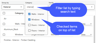

3. Easier filtering
Category, Family, Data Source and Area filters have been changed to support text search. All checked items are always displayed at the beginning of the list for easier unchecking.

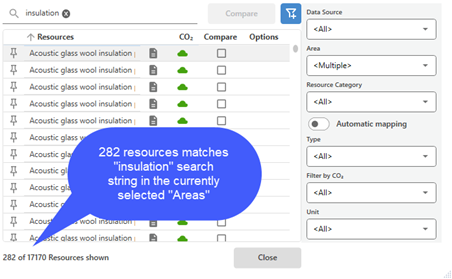

4. Information of how many resources that are shown with current filter
We have added a text showing the total number of available resources and how many are shown in the list based on the current filter.

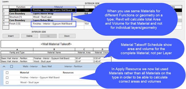

6. Materials for Types are listed as they appear in Revit Material Takeoff
When looking at Material for a Type in the Type list you see the Materials in the same way as how Revit will report them. A wall having two layers that are using the same Material will be reported as one and you cannot specify different resources for each of those layers for that reason.
This is the same way OneClickLCA shows Materials. In previous version, Materials assigned to an element in a loadable family were not displayed.
