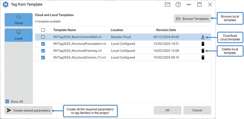

NEW! Tag from Template
Place tags efficiently across multiple Revit categories using a configurable template with predefined tag positions.
The Tag from Template feature ensures consistent and optimized tag placement by following templates with preferred positions for each family. Tags are automatically positioned in the best available locations, avoiding clashes or overlaps with other elements in the view.
In the Tag from Template configuration, you can select from existing templates stored in the Cloud or upload your Local templates:
Each template should include a tag family containing one or more tags with defined priorities to guide the tag placement process.
The Tag from Template tool will place the tag according to priority, starting with Priority 1. If that placement isn't possible, it will attempt Priority 2, and so on. If none of the priority levels work, the tool will move the tag linearly or along a defined vector direction to find a suitable position, avoiding overlaps and class conflicts.
You can configure tag priority and placement behaviour using type parameters assigned to the tag family:
  • NV Priority: Defines the tag’s placement priority level.
  • NVLinarTranslation or NVVectorTranslation: Determines how the tag should move linearly across the element or along a vector direction.
  • NVVectorMoveTolerance: Specifies the distance from the element after which a leader line should be applied.
  • NVTranslation: Enables the tag to follow the rotation of the element.
To create your template, download a Cloud Template that includes all required tag family parameters, make your modifications, and upload a new version using the Browse Template option as a local file. Alternatively, if you're starting a new project, click Create Shared Parameters to add all the required parameters to your tag families.

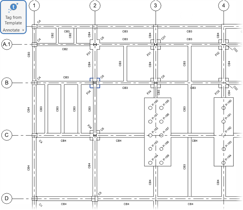

After selecting your desired templates, you can run the Tag from template tool directly from the Naviate S ribbon. All selected elements will be tagged. If no elements are selected, the tool will tag all applicable elements in the view based on the chosen templates:
It is possible to tag elements in Plan, Elevation and Section/Detail views using the corresponding template.
To maintain consistency across documentation, please ensure that elements within your template are tagged in only one supported view.
