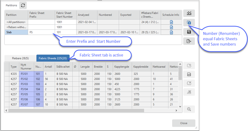

Number the Fabric Sheets by specifying start number and prefix per partition.
It is now possible to number fabric sheets on the same way as numbering rebars. When Fabric Sheet tab is active you have enabled functionalities for numbering/renumbering and saving numbers in selected partition.
Note! Revisions are disabled for Fabric Sheets, still you will get warning (yellow marking) if there is something wrong with numbering (duplicate numbers or the same position with different numbers).

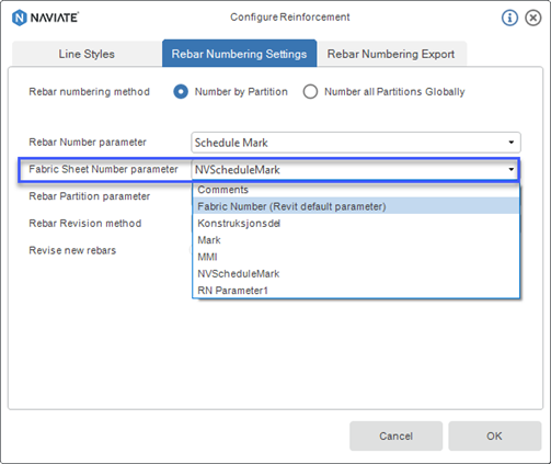

Configure what parameter that should be used for Fabric Sheet numbering.
You are now able to choose which parameter will be used for numbering Fabric Sheets, in drop-down list you will have all parameters that support Fabric Sheets. Default parameter is Fabric Number, that is Revit build in parameter and it can't be used for custom numbering, to apply custom numbering select any other parameter from the list (e.g., NVScheduleMark).
