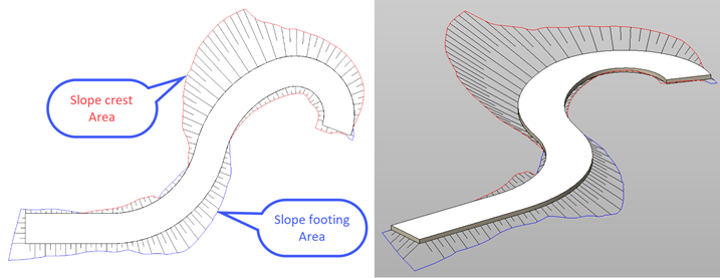

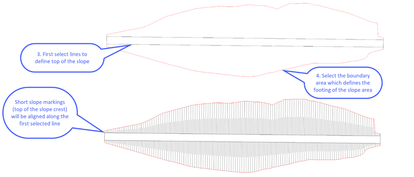

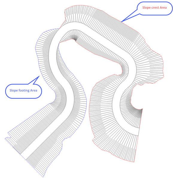

New! Slope Markings
Highlight slope areas on toposurface by creating Slope Markings based on selected boundary lines.
This new feature let you create slope markings by selecting manually drawn lines that define the slope crest and slope footing (top and bottom of the slope area).

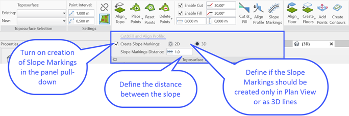

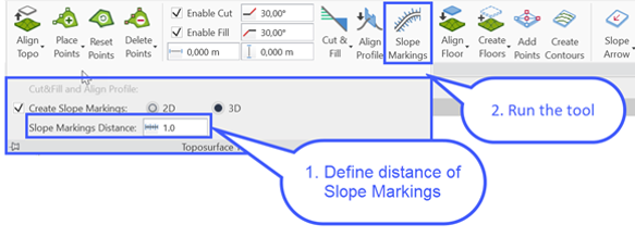

Cut & Fill
Automatically create Slope Markings based on the cut and fill settings.
This improvement will allow you to automatically create Slope markings when using the Cut&Fill feature.
Now when you run Cut&Fill you can let the feature Slope Markings based on the created cut & fill areas. You can choose to create the Slope Markings as 2D or 3D lines.
Align Profile
Automatically create Slope Markings based on the profile alignment settings.
This improvement will allow you to automatically create Slope markings when using Align Profile.
Now when you run Align Profile you can create Slope Markings based on the created cut & fill areas. You can choose between creating the Slope Markings as 2D or 3D lines.
