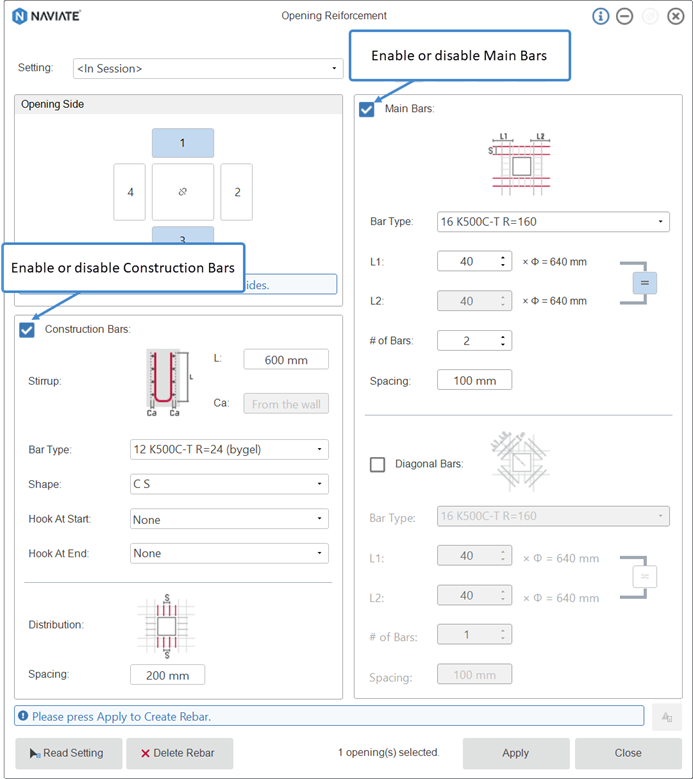

Opening

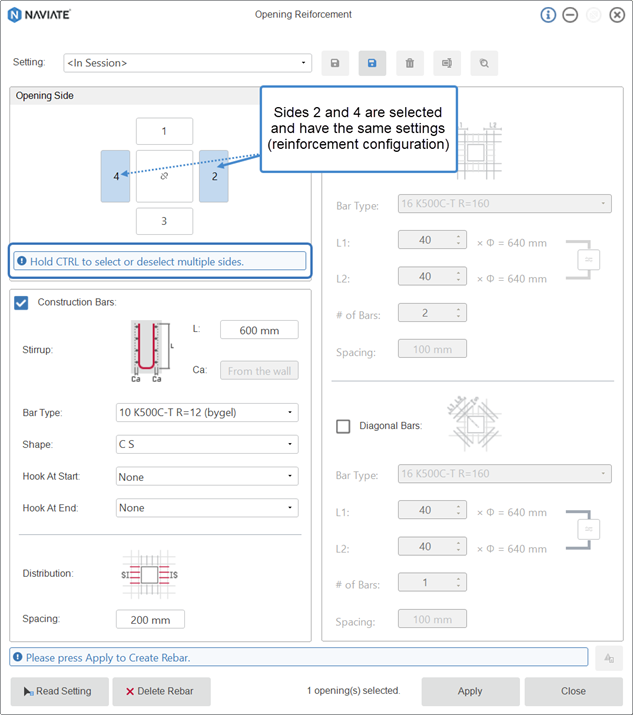

Select multiple sides of an opening simultaneously to adjust reinforcement settings.
Use Ctrl to select multiple sides of an opening. The settings from the first selected side will be applied to all selected sides, or you can configure a new setting for the preselected sides:
You can now enable or disable construction and main bars for Opening Reinforcement.
