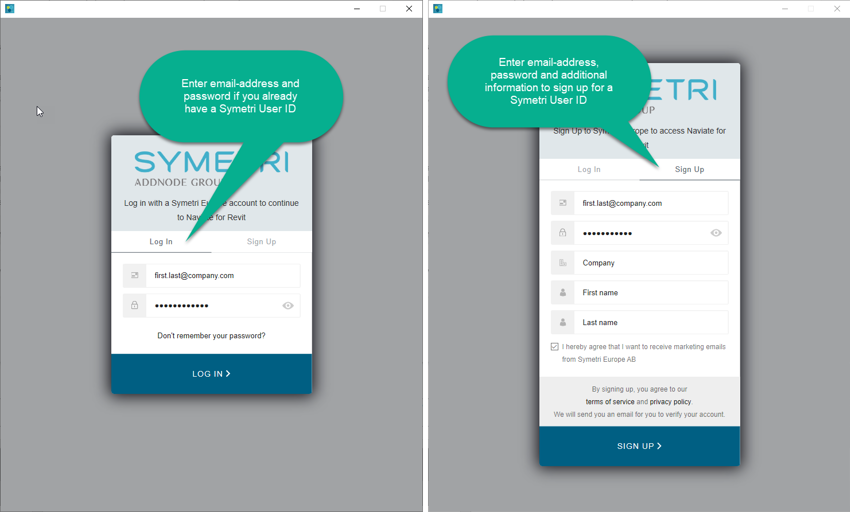

We introduce Symetri User ID for authentication when using Naviate 2022 applications.
A Symetri User ID is needed to run all Naviate 2022 applications except for Naviate Rebar Extension.
Create a Symetri User ID
- You can create a new account when you are asked to log in.
- Accounts can also be created for multiple users by the license administrator at your company using the new Symetri License portal. See below.
First time you start Revit after installing Naviate 2022 you will be prompted to log in. Either create an account, use existing account for Naviate.com or an account that License administrator at your company has created for you.

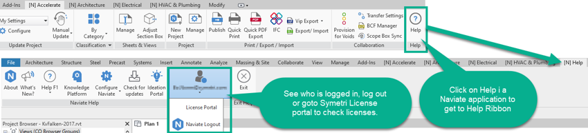

You can see who is logged in to Naviate and also log out from the Help ribbon. You activate the Help ribbon from the Help button in each application ribbon.

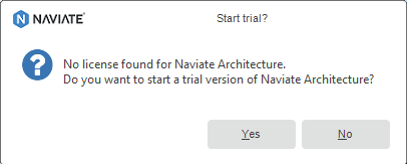

If you have installed a Naviate application that you don’t have a license for you will be asked to start a Trial. The Trial is valid for 1 month and can be activated once per computer. Once you have started a Trial you can use the Naviate application off-line during the trial period.
If you answer No when asked to start a trial you will not be asked again when starting Naviate unless you logout and restart Naviate.

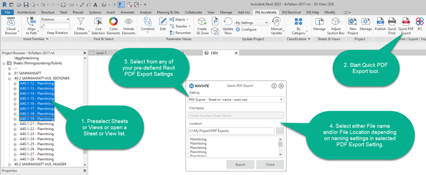

Quick PDF Export
Export current view or sheet, a selection of views or sheets or a complete sheet list with a few clicks.
The new tool creates PDF files for current selection using the selected PDF Export setting. Similar to Quick Print you can preselect a number of Sheets or a Sheet list in project browser and start the tool. But Quick PDF Export also allow pre-selection of views or a view list. If you start the tool without pre-selection the current sheet or view will be printed.
Select what PDF Export setting to use and file location or name. PDF Export settings are configured in the PDF Export tool found in Export tab in Revit File Menu.

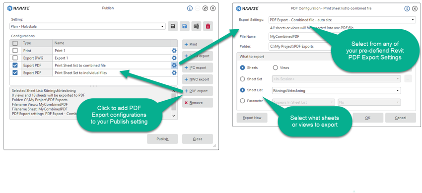

Publish PDF-files
Configure Publish to export PDF-files without using a PDF-printer driver.
You can now configure PDF Exports in Publish that let you create PDF-files directly without the need for installing and configuring a PDF printer driver. You have the same option to select what Sheets or Views to export as you have when printing, a Sheet Set, A Sheet or View Schedule or by using a specified parameter & value.
