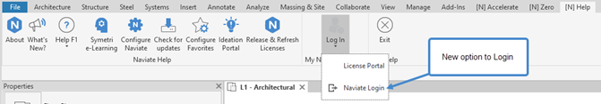

License Login
Login after start of Revit or after you have logged out.
You no longer must restart Revit to login again. We have added a Login option in Help ribbon to allow you to login after you started Revit/Naviate or after you have logged out from Naviate.
If you skipped login at startup you have to click on Release and Refresh tool (see below) to obtain a license after you have logged in
Note! You cannot logout and login with another account; you can only login using same email address that was used at startup of Revit/Naviate.
