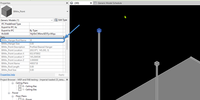

Added parameter to Point Family
Added "RodName" parameter to BIMrxPoint Family.

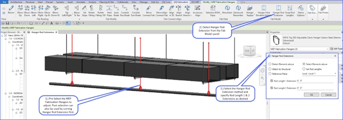

Hanger Rod Extension
Full Strap and Half Strap hanger types now function with Hanger Rod Extension command.
The Hanger Rod Extension tool within Naviate Fabrication now has functionality with Full Strap and Half Strap ITM hanger elements. This tool allows users to quickly adjust MEP Fabrication Hangers (Full Strap and Half Strap) rods to structures or extend the hanger rods by specified depth using different methods.
Note: When using Hanger Rod Extension on a Full Strap / Half Strap type hanger it will use “Rod Length 2” Extension.

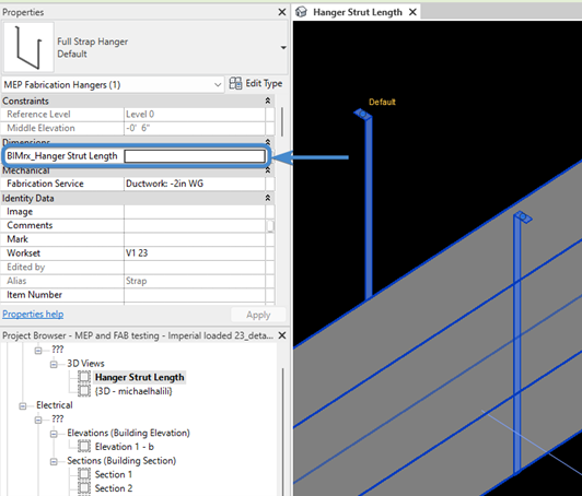

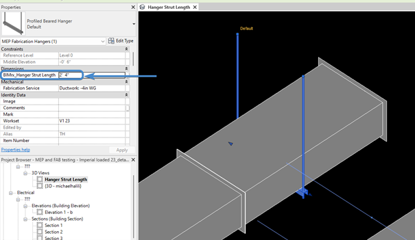

BIMrx_Hanger Strut Length parameter
"BIMrx_Hanger Strut Length" parameter now only populates for Strut Type Hangers.
Note that the "BIMrx_Hanger Strut Length" parameter will not populate for Strap, Round, etc. Hangers.
