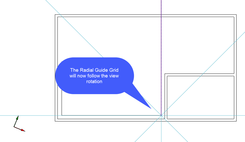

Draw Cable with Guide Grid improvement
You can now draw Wires using fixed angles also in a view with rotated scope box.
We have improved the Radial Guide grid feature to support drawing wires with fixed angles also in views with rotated scope boxes.

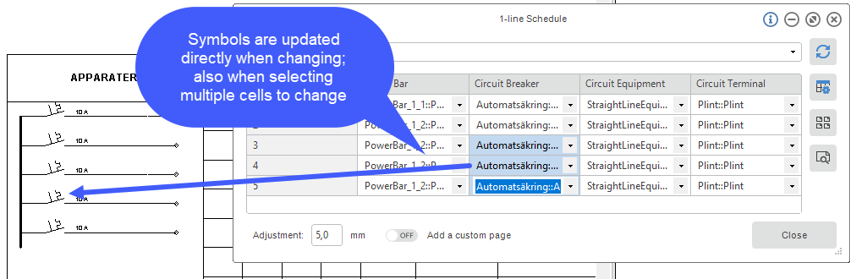

1-line Schedule Improvement
The 1-line schedule is updated directly when selecting a symbol in 1-line Schedule UI. No need to click on Refresh button to update complete 1-line schedule to see the result.
