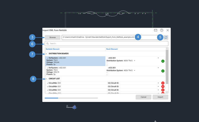

The main workflow is as follows:

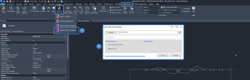

  1. Click Import XML from Nettdok.
  2. The Import XML from Nettdok dialog opens.
  3. Click the Browse button to open a File Explorer window and choose the .xml file generated by Nettdok.
  4. Once a file is selected, the file path will be displayed.
  5. The Refresh button will reload the .xml information from the file at the displayed path. Use the Refresh button if the .xml file was overwritten with new data and the table Nettdok-Revit Element mapping dialog will update.
  6. The search bar function will iterate over the project’s Electrical Equipment and Circuits for their parameter values, searching in a ‘contains’ manner.
  7. The DISTRIBUTION BOARDS header can be collapsed and expanded by clicking the caret (^) symbol. Elements grouped into DISTRIBUTION BOARDS include all Elements from the Nettdok file contained in the <ObjectList> tag. Each Element is then sorted/listed by the value contained in the <sRefSystem> tag. Available parameters that can by synced/mapped with the associated “Electrical Equipment” Revit Element (in the same row to the right) include:
    1. System
    2. Voltage
    3. Phases
  8. The CIRCUITS header can be collapsed and expanded by clicking the caret (^) symbol. Elements grouped into CIRCUITS include all Elements from the Nettdok file contained in the <CircuitList> tag. Each Element is then sorted/listed by the value contained in the <sCircuitNbr> tag. Available parameters that can by synced/mapped with the associated “Circuit” Revit Element (in the same row to the right) include:
    1. Schedule Circuit Notes
    2. NVFaser
    3. NVVernType
    4. Rating
    5. NVUtloserkurve
    6. Number of Poles
    7. Wire Type
    8. Load Name

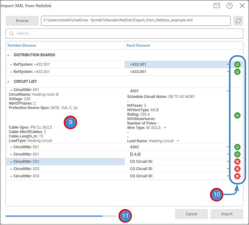

Referencing the image Figure 2 above, as each Nettdok Element is mapped to a Revit Element (9), a status indicator (10) will convey if the Nettdok Element is properly mapped.
  • indicates a successful mapping
  • indicates mapping is incomplete
The Import button will not be available until all rows of Elements are mapped successfully. Progress of this mapping can be tracked with the progress bar (11).
Once the Importing is complete, the property values in Main Workflow Step (7) and (8) will be synced for the Revit Elements in the Category Electrical Equipment and Electrical Circuits.
