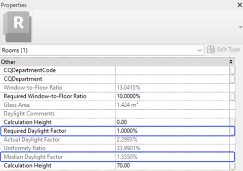

Swedish regulation standards
Added support for checking the required Median Daylight Factor of 1.0%.
Based on SS EN 17037:2018 and SS 914201 daylight regulation guidelines we will check if each Room is meeting the required Median Daylight Factor value.
You will also be able to save the Median Daylight Factor values of each Room on an instance parameter and use in schedules and tags.

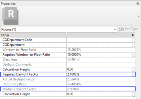

Danish regulation standards
Added support for checking the required Median Daylight Factor of 2.1%.
Based on BR18 and FprEN 17037 daylight regulation guidelines we will check if each Room is meeting the required Median Daylight Factor value.

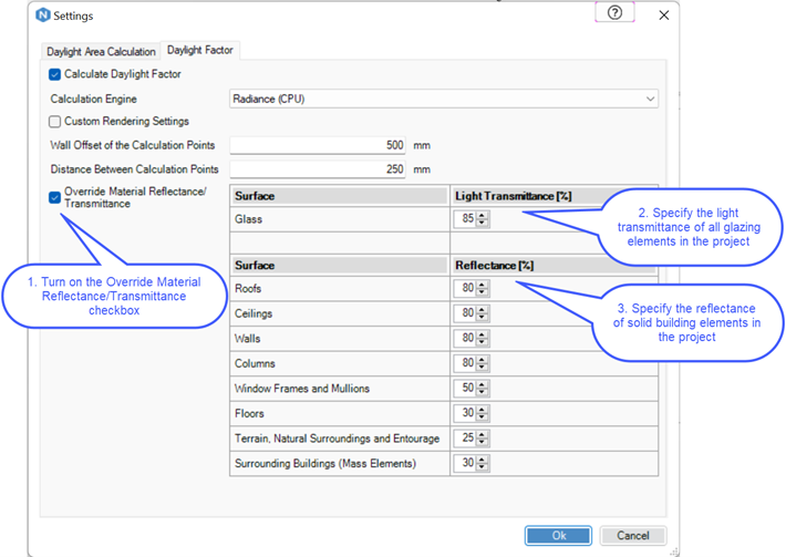

Daylight Factor
New functionality for defining material reflectance and transmittance values without the need to modify Revit materials.
You are now able to override material properties and define the reflectance and transmittance values of building elements when calculating Daylight Factor.

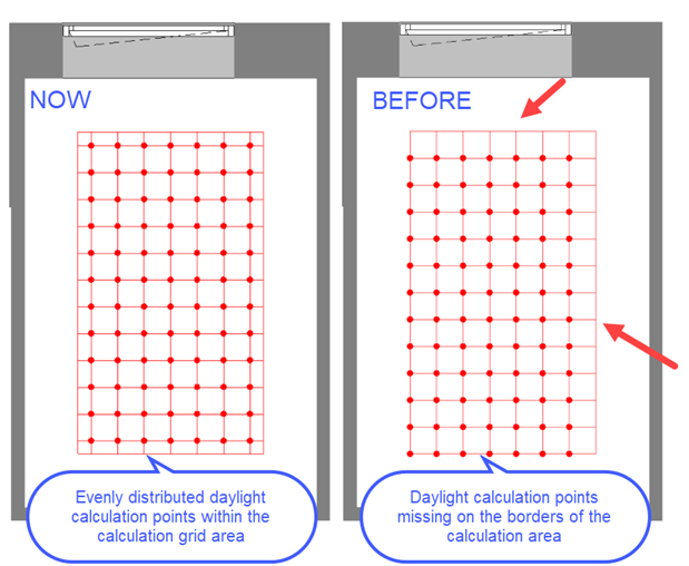

More precise calculation grid placement within the calculation area.
We now provide more accurate Daylight Factor results by calculating the needed number of calculation points for each Room and evenly distributing them within the calculation area of each Room.

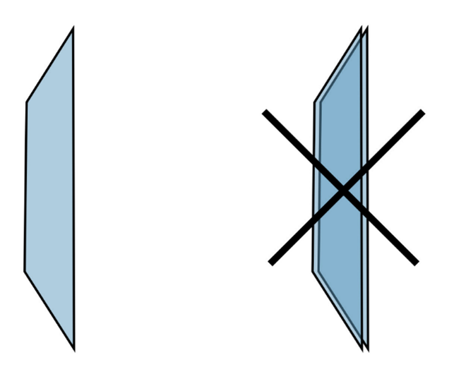

Improved export of glass surfaces based on Radiance manual.
We now provide more accurate, stable and faster Daylight Factor results by modelling the glass material as a single surface when exporting to Radiance.
