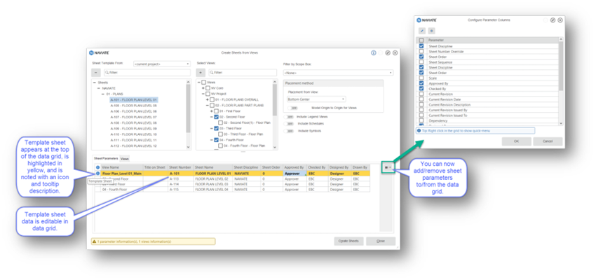

Create Sheets
The Create Sheets feature has been improved to show the template sheet in the data grid and allow you to add/remove parameters to/from the data grid.
The template sheet and its parameters will now appear at the top of the data grid in the Create Sheets UI. It will be differentiated from the new sheets by having a background color yellow and represented with an information symbol to the left of the row. When hovering your mouse over the information symbol, a tooltip will appear saying ‘Template Sheet’.
A new button to the right of the data grid was added to allow you to add or remove parameters to the data grid. This shows all sheet parameters in the project and will be saved to the project to be used next time you open the feature.
The following improvements have been made to the Create Sheets feature:
- Ability to see template sheet data at the top row of the data grid in both the ‘Sheet Parameters’ and ‘View’ tabs.
- The template sheet is highlighted in yellow and has an information triangle to provide tooltip that this is the template sheet.
- You can modify template sheet data.
- When modifying data for the template sheet, it will automatically apply to all other sheets in the data grid.
- You can perform data grid functionality to fill copy, fill increment, or fill custom increment from the template sheet data.
- New button in the UI added for managing parameters in the data grid.
- This was added to the ‘Sheet Parameters’ tab.
- You can select which sheet parameters to see in the data grid and remove the parameters that you do not want to see in the data grid.
- Settings for which parameters to show in the data grid are saved to the project.
