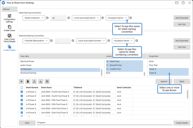

View and Sheet from Settings
Added Scope Box option when creating, naming and numbering sheets.
You can now create sheets for different Scope Boxes per level. The Scope Box name is incorporated into both the Sheet Naming Convention and the Sheet Numbering Convention. When adding sheets to the list, you can select not only View Sets and Levels but also one or more Scope Boxes.

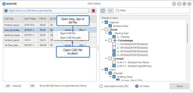

CAD Tracker
Added possibility to open a CAD file or CAD file location from UI.
Now you can open CAD files and file locations directly from CAD Tracker. To do this, simply right click on a linked CAD file and choose one of the available options.
