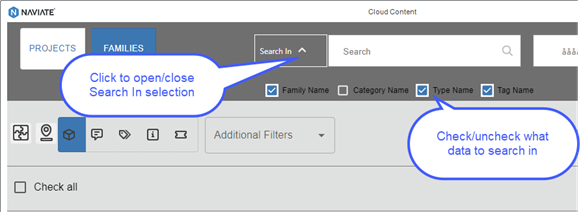

Improved free text Search and some UI improvements.
You can now choose what data to search in when doing a free text search. In previous versions, the free text search was only for Family Names but now you can choose to search in Family Name, Type Name, Category and Family Groups (Tags) as well.

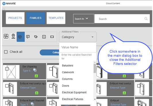

The pop-up UI for selecting Regions, Disciplines and Additional Filters can now be closed by clicking outside the pop-up.

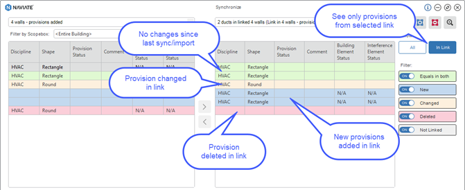

Provision for Voids
Easier updating of provisions when receiving updates and new tools for hiding/showing provisions in a view.
We have improved the Synchronize and Import tool to know from what provision element and what link the provision was created from. This helps you to understand what provisions that have been added, modified, or deleted when you get a new version of the linked file with updated provisions.
In Synchronize tool you can now filter to only see provisions from the selected link. And you also get a more detailed information of what has been changed when comparing to provisions that you imported from previous version of the link.
The Import tools has been updated to automatically add, remove, or modify provisions when reimporting provisions from an updated linked file. You are notified how many provisions that was added, changed or deleted.
We have also added new tools for turning on or off the visibility of provision elements in current view.

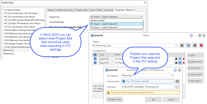

Publish IFC Files
Supports new Project Site settings in IFC Configuration.
Revit 2023 introduced new settings for Project Site. We have changed Publish to recognize and use the selected setting when exporting IFC files.
